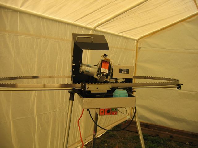

Well, I am a bit aggressive and use 1 1/4" wide 7/8" tooth spacing bands that are .042 thick (plus kerf), and for sharpening I just send them out....
To the shed!
Sorry, I just set this up today and couldn't resist! My bands last about 2 hours when I am slicing tops so I go through lots of them. This unit is quite expensive but I just HATE taking bands to the landfill when they can be used a few times first. I buy the bands in boxes of 15 and I will need to sharpen 7 boxes worth of bands to pay for the sharpener.
I know that almost all of you wouldn't use a system like this but thought I would share anyway! I have a tooth setter with it also.
